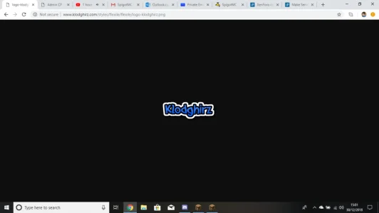

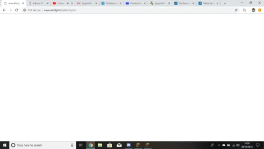

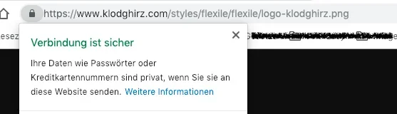

I did not see any issues with an certificate, Chrome says its all fine.. :unsure:
It's very strange.. If I made up a directory like /thisisannoying/ it says it dont exist and says its secure but if I do something like /styles/flexile/flexile/logo-klodghirz.png/ it'll show as insecure.
