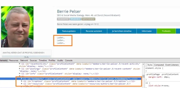

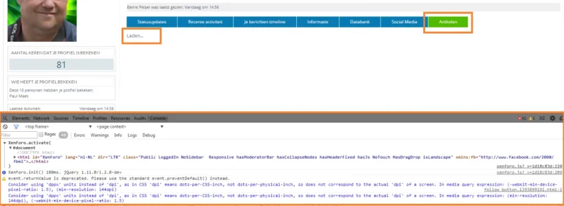

in member profile there's a tab with the XFA blogarticles a member wrote......but at clicking on this tab it does not show the members blog articles......instead it seems to keeps "loading" forever but not showing any blogs this member wrote.
this problem occurs also with the waindigo trophies > does not show trophies in tab member profiles.
Wrestled with this issue for several months....no one [even waindigo/hired programmers/xfa] seems to have any clue or any solution so i removed the trophies tab from member profiles.

I checked the console. There was an error caused by your flare plugin, but upon removing it the issue was not fixed. Unless you've made some template edits to the plugin or surrounding areas in XenForo I wouldn't know where to look. I would again discuss this with the developer.

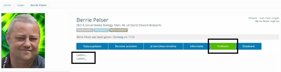

check this out.......this problem started to occur with the trophies from waindigo. It's the same issue as with the xfa blog.......memberprofile > trophies tab > does not show trophies
well....i deleted the trophies tab.......but in default style mode......the tab is still there and guess what......it shows the trophies when clicking on the tab as shown below.....
