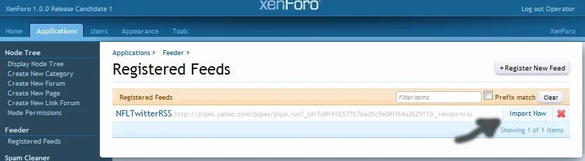

On your registered news feeds in your admin control panel click on the import now on the line for the feed your trying to push the post with. Importing will retrieve the feed as soon as you click. If you have it set to the 30 min default it wont get a post for 30 minutes from originally adding it i believe.

example.png I was having a problem with my feeds at first and i just applied this change today that trombones pointed me to and it solved all my problems I think. I don't know if it is related to this in any way but I ask have you used this fix yourself? I had used it to fix an issue with registering feeds.

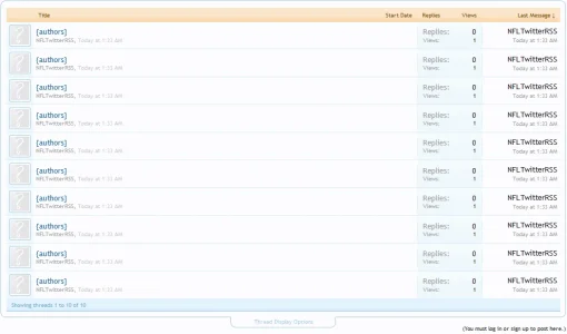

the misbehavior is in the title template processing it appears. If you use {title} on this twitter rss seems to stop processing. I notice you are using {authors} it looks like. Still trying to get eclipse with a debugger to connect locally blah.
