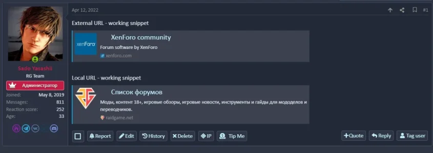

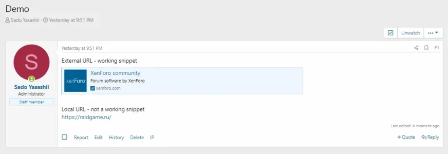

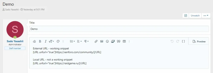

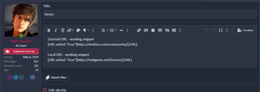

Tell me please. I want to move from .NET domain to .RU. I do the transfer of physical files, change in the settings of the URL, as well as edit possible links from the old to the new domain. No problems in work, but for some unknown reason, snippets stopped working on internal addresses, but external ones work without problems. At the same time everything is fine on the old domain. For the test installed XF on a clean base for a new .RU domain and there I see exactly the same problem. I turned to his hoster, the problem with their side did not see, they say go to the developer.

According to his analysis, as if there is not enough loaded meta-logo for the output image. For the test downloaded, the result did not give. I do not understand what do not like, any ideas?As far as we know, the following OG tags are required to display the snippet correctly:
