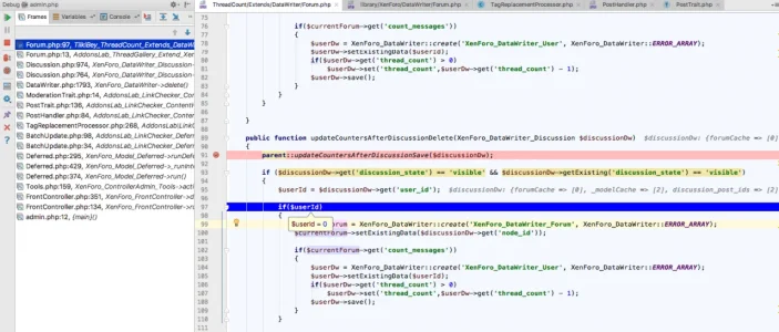

In that case, I am not sure how the issue could happen. Maybe some another add-on is causing the problem. I have one more time tested it with the Thread Count add-on installed, posted a thread with a user, then deleted the user (the thread became posted by a guest and DB was updated to have user_id 0 in both xf_thread and xf_post tables), found a link from that thread (from the first post), and deleted the post. The product was called, properly executed, and line #108 causing an error in your case was not called, as user_id was 0. The screenshot is attached from this state of processing using a debugger.
So we are completely sure this is not a bug in our product and most likely also not in Thread Count add-on.
