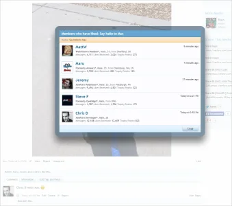

If I like a media item that already has at least three likes and click on "X other person / others," the like listings overlay appears broken:
I have to refresh the page to rectify the issue.

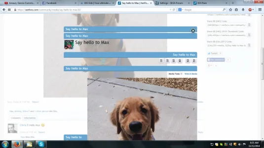

  1. Go to a media item that has at least three likes
  2. Like the item
  3. It'll appear as "You, A, B, and 1 other person / X others like this"
  4. Click on "1 other person / X others like this"
  5. The overlay appears broken
If you already liked an item, clicking unlike will result in the same issue.
Refreshing the page makes it appear correctly.
We just realised how to reproduce this.
It is fixed now, thanks.
The changes will be rolled out here in the future.
The URL used on the likes_summary template should have been defined as 'xengallery/likes' or for albums 'xengallery/albums/likes' but, the 'likes' part was missing, hence the likes_summary link actually pointed back at the content; hence why in your screenshot you saw the media item try to load again in an overlay rather than the actual likes summary.
Ah, I see. So how did refreshing the page make it appear properly?
It specifically relates to the AJAX action that updates the content of the page. That action was replacing the correct link with the incorrect link.
