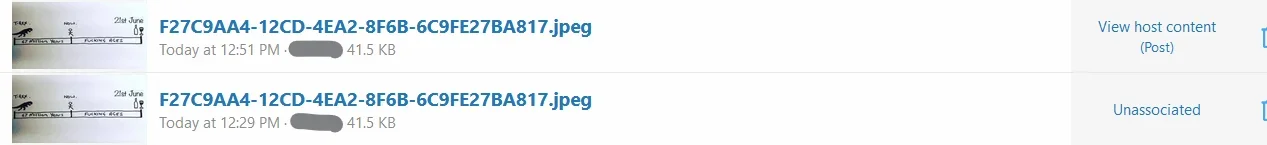

Fixed Legit attachments sometimes marked as "unassociated" and disappear after 24 hours
I mean it's possible it could be related but there's clearly another aspect to that particular issue which is the message too long error. Currently I do not believe it is related.
Please bear in mind that attachments being unassociated is an entirely expected and normal part of the attachment upload process until the content is submitted which is the point at which the attachment is associated to the content being created. Clearly on that one occasion it happened, something else occurred which we've not seen any other reports of hence why it is being kept as an entirely separate report for now.
Any further comment specifically related to the "Message is too long" error should be kept in that other thread.
It looks like someone may have reproduced the issue here and others may have been able to reproduce without add-ons enabled so currently add-ons aren't believed to be a factor.

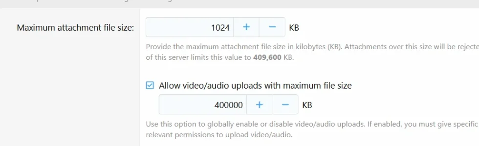

Can you check your post_max_size value (you should be able to see it from the server environment report in your Admin CP) and see if it is higher or lower than your configured max upload file size in Options > Attachments?
This is typical of the issue when it materialises...
So far I haven't seen any errors relating to this with our ACP
ACP: PHP post_max_size 400M
From Options>Attachments...
