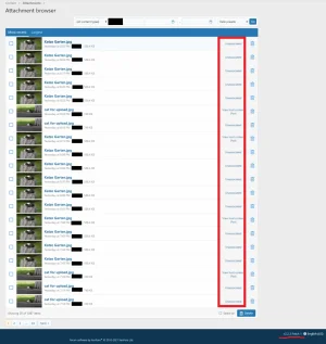

Sometimes legit attachments are disappearing after 24 hours. The members make the post fine and it all goes through, but they're marked as "unassociated" and are deleted by xenForo when it cleans up unassociated attachments. There's no dead image(s) when the post is published.

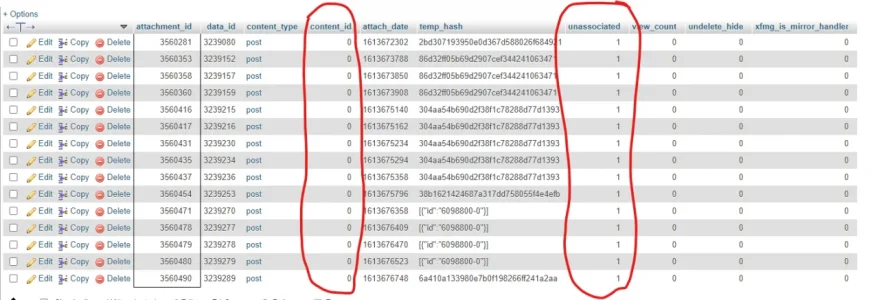

I've noticed:
If you copy/paste the image, you get the attachment URL and a hash.
The image attachments work fine in posts. There's no dead BB Code when the member publishes their post. If you copy/paste them to get the attachment URL, you'll get it and a hash. If you copy/paste the attachment from a post that isn't affected by this issue, there's no hash.

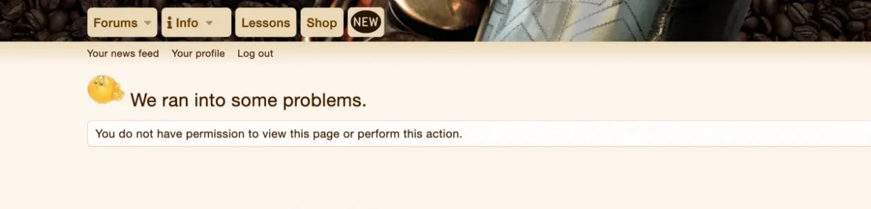

Permission error when loading the attachment directly without a hash
If you remove the hash part of the URL and load the attachment URL directly of the problematic attachment that's marked as unassociated in the admin panel, that's when it'll say "You do not have permission to view this page or perform this action".
The image loads fine in the post itself until xenForo cleans it up after 24 hours.
If you try to directly load an attachment URL that's marked as unassociated (when it should have been a associated with the post) without the hash in a private browsing window, you'll be prompted to a login screen. If you're logged into an account and view the URL without the hash, you get the permission error.

After 24 hours, the above changes to a dead attachment link. Clicking it will then say "The requested page could not be found." Our members lose their attachments when the system marks legit attachments that are posted as "unassociated".
This issue has even affected staff members and they've confirmed they didn't take a long time to write up their posts and leave the uploaded attachment to linger for the unpublished post.
