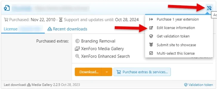

Can you please check your validation token in the XenForo customer area - the domain on your license doesn't seem to match your forum domain. Should be an easy fix - just edit your license information and make sure your Site URL matches where your forum is installed.
To test whether your changes work, you can force the system to send new user agents by going to Admin > Tools > Known Bots > List dectected bots and clicking on the "Send user agents" at the top of the page.

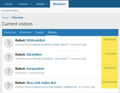

You can already see this in the Members section - look at the Robots tab, which will include all bots identified by KnownBots and will also show the IP address:
Yes I know, but it would better to see the IP(s) also in the last bad bots list at ACP who I can see whats going on the last 100 hours and not only the last 30 minutes. :-)
There I see a list with every bot only one time and there it would be great to have a button wich opens a list with all IPs this bot (user agent) have used last 100 hours. That can be realy helpfull to block bad bots, espacialy this with changing user agents or with user agents like members have.
I the list from your screenshot, I have to sit one ore more days in front of my PC and wrote the IPs handy on paper. I think thats not a real good solution. You dont?
