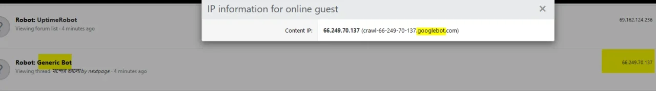

@Sim Does Googlebot changed name is Generic Bot? Also Generic Bot name are not clickable or link missing.
Generic bot means that the user agent string wasn't definitive enough for us to determine whether it was a genuine bot or not - there are a lot of Googlebot "clones" out there and bots which pretend to be Googlebot so they are allowed through firewalls and such.
I use the catch-all term "generic bot" to mean "it's definitely a bot, but I can't really tell which one" - which is also why there's no link - because I don't know what bot it is.
I'd need to see the actual user agent string to work out what has happened here - if it's genuinely a Googlebot, it should be identified as such - so I've probably got the match strings wrong there.

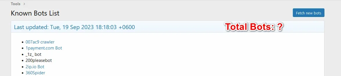

Our all Googlebot are showing Generic bot but before all are Googlebot. Now we haven't anymore Googlebot.
hah. i can confirm. i do not see googlebot in robots page. running Known Bots: Fetch New Bots from API didn't fix it!

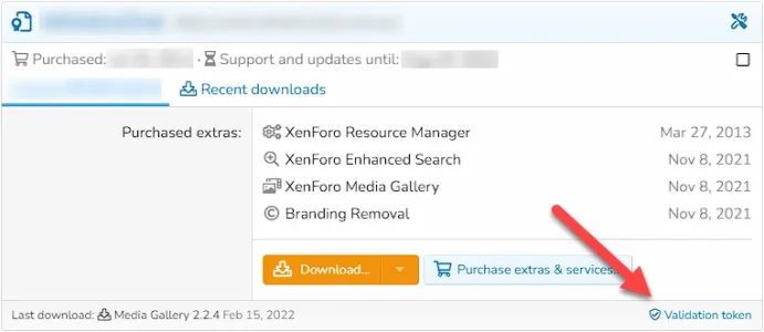

Here is where to find your customer validation token:
... click on that link and you'll get a screen similar to the following:
The validation token is the 32 (or 35) character string similar to what I've highlighted above. This is what you'll need to enter into the addon options for validation.
If you regenerate your token, validation will fail once your 28 day API token expires, at which point if you wish to continue using the KnownBots API, you should change your addon options to use the newly generated token.
