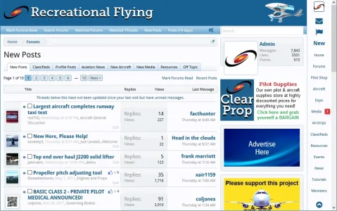

When selecting the various ares with the Whats New section the main menu tabs jump between the different section specific to the Whats New area you are looking at. For example when in Whats New and you select New Media, the Media menu tab is shown selected, new forum posts and the Forum menu tab is shown selected.
Instead of it jumping around when in the Whats New section, what do I need to edit to keep the Whats New menu tab shown as being selected...thanks for your help

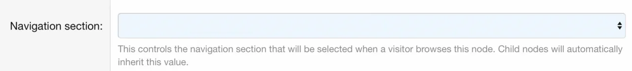

Hi Bassman,
Thanks for your answer.
That is what I would like to do but for a Xenforo Resource Manager category, not for a forum element.
Unfortunately this option is not available for a XFRM category.
Thanks
