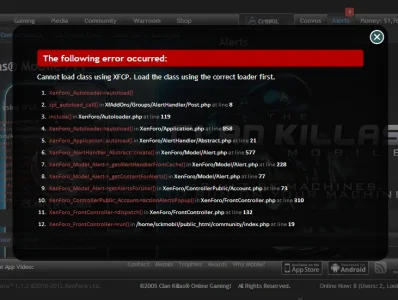

XF 1.1 Just got this error - any clues how to fix?:
CritiKiL
This error is now showing up in my ALERTS as a notification. BTW: I have changed 'nothing'. When I click on it, this is what shows. Does anyone know how I can get this fixed so that it doesn't return? Thanks in advance ;-)
Now there's a new error asking for me to check my browsers JavaScript console. So when I look there this is the new error listed in the JSC:
PHP <br />
<b>Fatal error</b>:  Cannot redeclare class XfAddOns_Groups_ModelOverride_Post in <b>/home/sckmobil/public_html/community/library/XfAddOns/Groups/AlertHandler/Post.php</b> on line <b>8</b><br />

There looks to be a Social Groups error as well. Not sure if it is related.
EDIT:
PHP <br />
Looks like it could be related.
