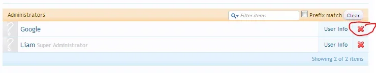

You only need a password to edit the administrator, if you click the red 'X' next to the administrator on the list of admins, no password is requested:

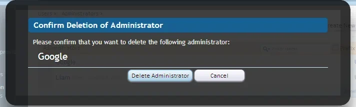

Clicking the 'X' brings this up:
Clicking the delete button just deletes the admin, without asking for a password.

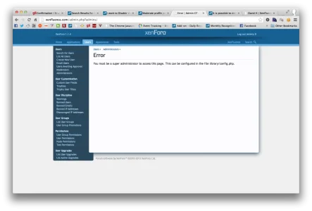

Also, you can only access the page to delete admins if you're a super admin.
