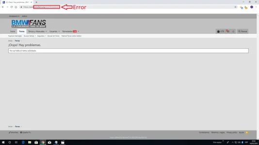

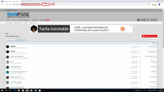

I have a problem and it is the following one, I can not pass of the 1 page of conversation here in the first image we can see that the page number 1 is seen.
195603
if I give to page two we get another address and not as it should be / conversation / page-2 then it is not going to the following address: threads / 2
195604
has happened to me when I upgrade to 2.1.0 does anyone know how I can fix it, and what does this do to me?
