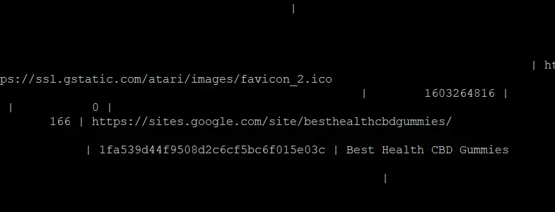

I’ve noticed that this table is constantly being populated with what looks like spam links. The strange thing is that these URLs do not appear to exist in my "xf_post" table — I’ve checked via terminal using SQL queries and found no matches.
I tried truncating the "xf_unfurl_result" table yesterday to start fresh, but it has already begun filling up again with the same suspicious links.

I hadn't cleared the "xf_unfurl_result" table for 7 years, and it had reached 70 MB. I assumed there was a built-in XenForo tool or cron job to clean it up, but when I finally looked inside, it was mostly filled with spam links.
I truncated the table, but it started growing again the next day, despite having no new registrations or posts with those links overnight. I’ve scanned posts, conversations, signatures, and everything else I could think of — these links simply do not exist on the forum. I’ve just cleared the table again to see what happens in an hour.
