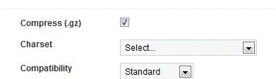

aiman.h.kallaf
what are the best values for this picture
and how to back up the data base then from php my admin , or what is the best way to back my database

The best way is to get command line access to your server. This is usually done using telnet or ssh. Sometimes in your hosting cPanel you might have an option to open an SSH connection or Secure Shell connection, or similar?
If it's a VPS rather than a shared server then you might have something like kvm access to control it directly.
Your hosts might be able to give you more specific information.
PHP My Admin doesn't do a great job with backing up databases either unfortunately.
