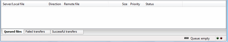

rEd86
I am noticing random "Connection Timed Out. File Transferred Failed." errors. I am using FileZilla for the ftp. I scrolled up as far as I could to find some fails, but it seems the data spools off the top and is gone. I tried manually transferring some of the failed files and they uploaded ok.
It sounds like you are not getting all the new files uploaded to your site.
What version of FileZilla are you using? The latest versions actually show Queued files, Failed Transfers and Successful transfers in tabs along the bottom of the window. (Under the "View" menu, make sure "Transfer Queue" is checked)
Try uploading again and wait for all the queued files to transfer. If you see failed files in the "Failed transfers" tab, you can view what didn't transfer and right-click on the list to "Reset and requeue all" to reattempt to upload the failed files. When they are queued (showing up in the Queued files tab and not the Failed Transfers tab) you select the "Transfer->Process Queue" menu item. Keep doing so until there are no files that have failed to upload.
Good luck!
