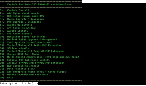

Easiest solution is to get @eva2000's CentMin Mod and use it. Works like a charm but has no graphics panel and assumes some working knowledge of accessing a server via SSH. It's not that hard to do and WELL worth the time it takes to learn for the increased performance benefits.
I've been using it for years and have been WELL pleased with it.
Most of the simple administration is text based menu
The added benefit is you don't have issues with security holes that you can find with many of the free web based control panels.
Now, if you want to host your own mail server (which is another issue in itself getting it recognized by the major players like Hotmail, Google, Yahoo, etc) then you have to do like I do and set up a separate VPS (I use mailcow dockerized to host all my domains) and configure mail services on it. You can do it on the CentMin server but it's easier to just get another VPS and use one of the prepackaged mail server setups.
