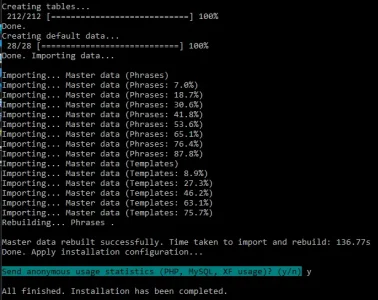

Installation is super slow on localhost
I don't think so. On mariadb server everything was fast, but no with mysql i wonder why?
I was forced to use mysql because of laravel. Whenever i do bug with foreign keys i get errors, on mariadb no. And when i publish on my live site i got 500 errors because of miss configured foreign keys xD.
I'm using default values on mysql. I wonder what cause this issue ?
CPU: Intel core i5
Ram: 4 gb ddr3

I've installed now XF 2.2 on localhost after 2 hours or less installation time so i can build my addon downloads manager
