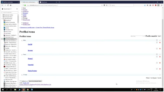

Hi, when install or upgrade add on they stop install and after refresh ask to do it manualy, no any error logs, no blank page nothing, also Rebuild XML Sitemap GIVES me this error
403Forbidden
You don't have permission to access /admin.php on this server.

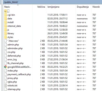

I just wanted to check in and let you know that I am able to replicate the 403 error on your site. This error seems related to the permissions currently on the admin.php script, however only when being called by a specific 'run-deferred' call from your sites software.
At this time, I am continuing my investigation to verify that cPanel is not related to or causing this issue.
Once I have more information to provide, I will reach out to you again on this ticket.
If the owner and permissions are the same as index.php then this shouldn't really be happening AFAIK.
As mentioned in that other thread.. have you confirmed the ownership and permissions of admin.php (and probably need to on all files if that one is bad).
