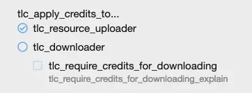

Taking what you have said literally, you're saying that if the radio has a value of uploader then the require_credits checkbox is not disabled.
This is the code I am testing with:
HTML:
<div>{{ phrase('tlc_apply_credits_to...') }}</div>
<xf:radio name="{$inputName}[apply_credits]" value="uploader">
   <xf:option value="uploader">{{ phrase('tlc_resource_uploader') }}</xf:option>
   <xf:option value="downloader" label="{{ phrase('tlc_downloader') }}">
      <xf:checkbox>
         <xf:option name="{$inputName}[require_credits]"
            label="{{ phrase('tlc_require_credits_for_downloading') }}"
            selected="{$options.require_credits}"
            hint="{{ phrase('tlc_require_credits_for_downloading_explain') }}"/>
      </xf:checkbox>
   </xf:option>
</xf:radio>
And that gives me the expected results:
196573
