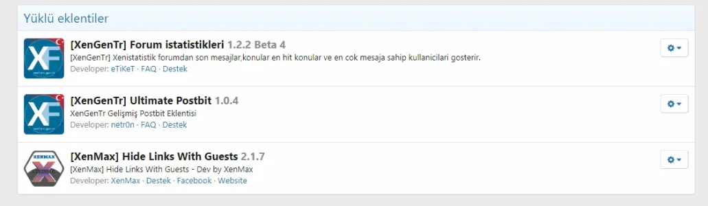

Using both addons.
I'll send a list with all I use at the moment via PM.
Thanks for your reply.
I don't use Tapatalk but I do use that addon by @Xon and several others. When we did the whole process of truncating and duplicating the table, it started to get better. Though we are still not aware of what caused it to begin with and if it will happen again.
The problem has improved when I removed this code. I do it once now I do not know what caused it. There may be a problem when we passed 1.5 version.
