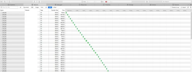

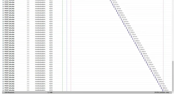

Don't ask me why, but every visitors on my forum are calling the job.php file (via XHR request). That's making a huge amount of unwanted HTTP requests.
I searched every JS and PHP files on my server to find a backdoor, but nothing...
Here is an example :
Any ideas ?

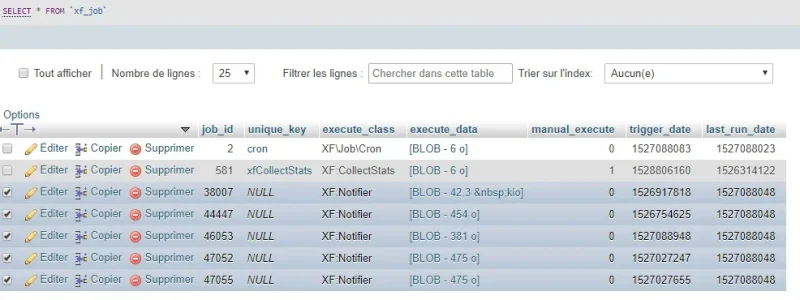

I removed the strange entries from the xf_job table.
Here it is.
Any ideas on what it was ?
We made the DB changes without consulting you because it was urgent, it was like we faces a DDOS with our own visitors.

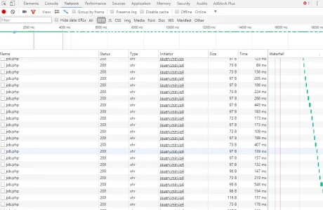

Yes but each user was making one request per 500ms, infinitly. I don't know if it is a XenForo bug, or an addon's, but that was unwanted.
My logs were saturated, and it was making my server lagg due to the amount of requests.

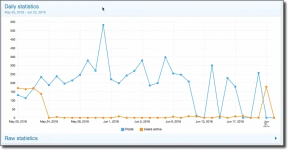

In addition to the numerous rows in xf_job and the endless job.php calls, and (in my case) cron jobs not running, my reported daily active users dropped to 0, yet I still have daily posts. I'm also not receiving emails for subscribed threads, but email works just fine when I manually send one from the admin panel. Yesterday, when I manually turned all cron jobs off, then back on again, I got some user stats to appear.
Could this possibly be related to the GDPR release in late May? I installed v2.0.6a right around when the issues started. I've tried rebuilding all caches a few times to no avail. I've since installed v2.0.7, but that hasn't helped either.

I have this problem too, i truncated the table but the problem reapears randomly in some threads with members subscribed to reply notifications, i suspect from some addon like user mentions improvements or tapatalk :/
example of endless job:
a:5:{s:7:"service";s:24:"XF\Service\Post\Notifier";s:5:"extra";a:2:{s:6:"postId";i:4982893;s:10:"actionType";s:5:"reply";}s:10:"notifyData";a:4:{s:5:"quote";a:0:{}s:7:"mention";a:0:{}s:10:"forumWatch";a:0:{}s:11:"threadWatch";a:1:{i:152692;a:2:{s:5:"alert";b:1;s:5:"email";b:0;}}}s:7:"alerted";a:0:{}s:7:"emailed";a:0:{}}
Literally, nothing.
In the databases I've seen, there's no logic for the alerts being stuck. The code itself seems like it shouldn't happen.
