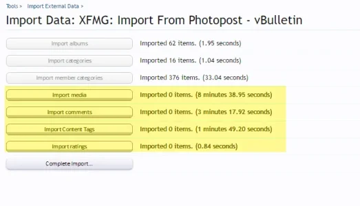

I'm attempting to import some 4,915 images with over 3,700 comments from PhotoPost Pro to XFMG and am running into an issue I have no idea how to solve. So I'll appreciate assistance. The issue:
Albums, categories and member categories are imported just fine. The importer runs for several minutes seemingly importing media but returns the result -- as seen in the screencap above -- of 0 imported items for media, comments, content tags and ratings.
How can I correct this issue please?

Typically the cause for this would be not being able to find the original media files.
We actually do a look up of the PP database to find the correct location, it's possible that this is returning a path that doesn't make sense in relation to your XF installation. Do you have access to the PhotoPost database? Can you perform the following query?
SELECT setting FROM pp_settings WHERE varname = 'datafull'
(You may need to replace pp_ with the correct prefix, or remove pp_ if there is no prefix)
The easiest thing to do at that point is just move the files to that location, or update that setting to reflect the location where the files are now.

Hey Chris. I've run the query and see
/home/website101/public_html/photopost/data/
Only thing is the photopost files are actually located at
/home/public_html/website101/photopost/data
I should say that I've created a development board on a different server for this particular project. So the file location could be at issue as you've said. Is there a query that I could run to automatically update the setting to the correct location? I'm not at all a backend administrator - so I'd need quite detailed instructions on how to actually do this o_O

Running a query similar to this should do it:
UPDATE pp_settings
SET setting = '/home/public_html/website101/photopost/data'
I would say that it is this that most likely caused it to fail.
Depending on the server configuration, 755 could be fine, but also I would possibly expect it to throw an exception if it was a write failure to internal_data (though don't quote me on that).
