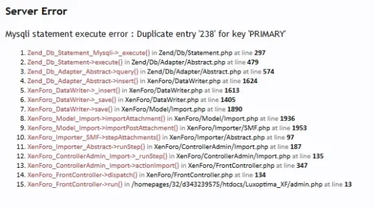

And then when I get back to the import panel I've got those errors :
Do you have any suggestions ?

Indeed. You will need to address the first error first because resizing images is quite intensive (at this stage we're copying all of the images and creating new thumbnails for them). The solution would usually be to raise the max_memory_limit in PHP. XenForo usually tries to override this at run time to 128M but you may want to consider that as a minimum and go higher if you can.
After that, you will need to delete the most recent attachments. You should be able to delete these from the Attachment Browser in the Admin CP. It's currently trying to re-import the attachment with the ID 238 and it already exists (hence the duplicate error).
In the attachment browser, if you hover over the attachments in the list you'll see a URL like:
http://yoursite/admin.php?attachments/file-jpg.238/view
That would be the one you delete, though depending on how far it got through the process you may need to do this multiple times before it can continue.
Another solution would be to start the import again, but depending how large the import is, that may not be trivial.

I've tried that but it's running in circle : if I delete picture 238 then it stop on picture 239...if I delete picture 239 it goes back and stop again on 238.
If I delete 238 and 239 it stop on picture 240 ... if I delete 238 and 239 and 240 .... then picture 241 (or whatsoever)...should I continue this way : by deleting n pictures, then n+1, then n+2 pictures or am I supposed to delete only one picture at a time ?
Yessss ! (y):D(y):D(y)
Thank you very much for your help, it worked fine!
