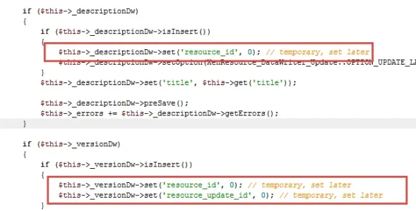

Yes you are right you are not seeing the right IDs and that is not because of the deleted files in vbulletin, it's because of the lazy approach I took to make sure Ids carried over.
For now, do this
Open the thread DataWriter in xenforo
library/XenForo/DataWriter/Discussion/Thread.php
On line 175 comment out this line
PHP:
//$this->set('prefix_id', 0); // invalid prefix
Basically the "right" approach would have been to extend the thread datawriter with an addon and creating a new column in the thread table to use to "pass" the resource id from file id. But I took the shortcut of passing the id through the thread prefix column (Since I am deleting the threads, it does not matter!). That is why you are seeing wrong ids because the prefix check in the datawriter is silently failing. (if you are using my importer).
Comment out the above line and try again.

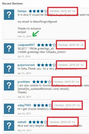

BTW Sadik, don't forget to run this query to update the version date of the comments. In you website it is all 14/7/2015
update xf_resource_rating
set version_string = DATE_FORMAT(FROM_UNIXTIME(rating_date),'%Y-%m-%d')

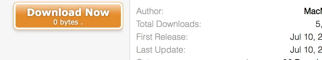

This worked great for me except for one problem... download links don't work. :P
All of the information about a download from Downloads II is present, name, image, etc, but the file itself doesn't seem to be linked to it properly.
Not sure if I missed a step.
This worked great for me except for one problem... download links don't work. :p
Figured out what was up. I noticed that some files were actually fine, and it turns out it's because my test importing was done with an older vBulletin db copy. Between when I made the copy and now we updated the files used by some downloads, so the files in the directory didn't match what the old db copy had. Those that were still the same worked as expected. Mystery solved!
