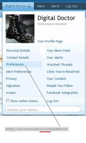

(2) URLs in Xenforo.
When your users are on a page or forum or thread, xenforo adds that to the URL.
/forum - when in a forum
/thread - when reading a thread
/pages - when on a page Q: What is a "Page" ?
/post - when posting
/members - member's Tab
/help - Help Tab
/account - Account Preferences - http://xenforo.com/community/account/preferences
/watched - watched threads - http://xenforo.com/community/watched/threads
/search - Search - http://xenforo.com/community/search/?type=post
