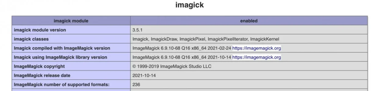

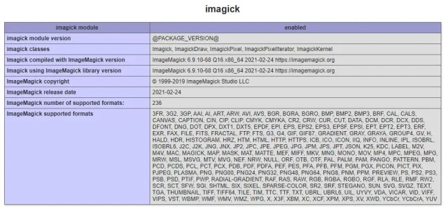

6) Verify imagick is now running under PHP 8: Open XenForo AdminCP.
Server Environment Report should now report Imagick Support as "Yes" when running under PHP 8.
AdminCP -> Tools -> PHP Info
Should now contain imagick section when running under PHP 8.

A general 'Thanks' to everybody to who's given input on the topic of ImageMagick & PHP8. 👍
After going to PHP 8 I switched over to using GD but the resized images just weren't as sharp as when using ImageMagick. I'm back up & running with ImageMagick.

Is yum installing the latest ImageMagic version 7 or is it still installing version 6?
