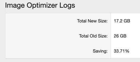

9 days active, and ¼ of the way through all attachments so far. Quite a good result thus far ...
can you tell us how you know how much it has processed of the total number of image files?
File numbers aren't given, just total size and logged activity.

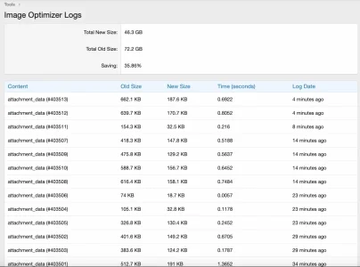

Logged activity appears to show that it's now completed all existing files, and just working on new files added ?? But those attachment id's suggests there's another ~3k to go ?? Based on the number of files being processed for each 5 minute run ...
I now/currently have 61 Gb in internal_data/attachments/ and 40Gb in data/attachments/. The above saying 72Gb was the pre-addon size. The DB log says it's done ~372k image files, I have just over double that within those directories. It's impossible that I have ~30Gb in non-image attachments, so I don't really know why the discrepancy.
Regardless, a 35% drop from 72Gb to 43Gb - and the improvement in site load speed from lower size images - is impressive.
