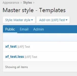

2. Created 2 templates with test code:
3. Created a template modification to show the test code below forum title on forum_list:
4. It shows like this:

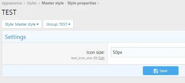

5. Changed value for icon size in master style, saved and no effect:

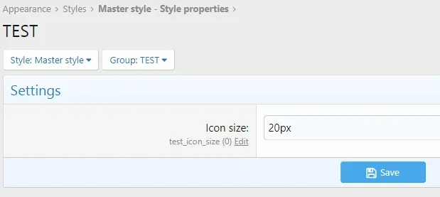

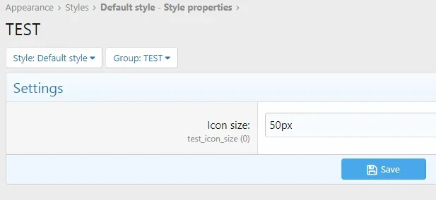

6. Revert back to 20px icon size in master style, then changed value for icon size in default style, saved:
7. Result:
7. Result:

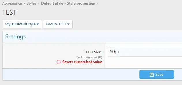

Curious, at step 5 when you change the value in the master style to 50px what does it show in the default style?
Good question, @Steve F.
I changed value to 50px in master style. Nothing changed in frontend. But when I change style properties to default style is looks like this:
Of course still no effect. I click Save button now in default style and no effect. Revert value in master style, changed value in default style and effect is visible.
