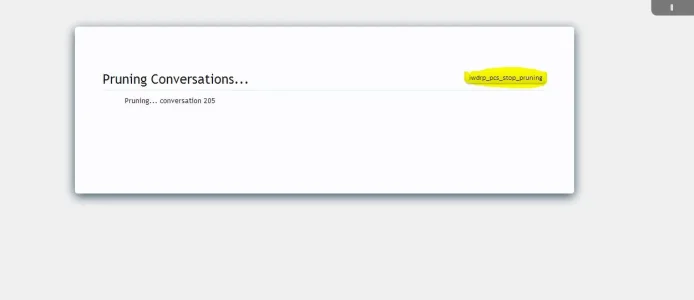

If you have a large number of PC's (my board has 200,000 or so) you should up the batch size of how many it prunes per pass considerably, otherwise you will be waiting a very long time.
That is, unless lawrence increased the default batch size after I tested it for him ;)
Is this phrase normal?
Nope. :) I renamed the phrases for consistency before I packaged it, and that one slipped through as I had very few PC's to test on my forum, so I had no time to notice it while testing. I'll fix it today.
I doubled it. I also made it so that it displays the amount of PC's that will be pruned, so Admins can set the batch number according to the number. I need to fix the phrase above, so I can increase the default for the batch, but I'm not sure of a good number to use. The reason I kept it low-ish was because there are four tables where PC's will need to be deleted per cycle. And thanks for testing, I was surprised at how many PC's you had pruned :eek:

I got this:
Server Error
Mysqli statement execute error : Duplicate entry '0-1_day_ago' for key 'language_id_title'
  1. Zend_Db_Statement_Mysqli->_execute() in Zend/Db/Statement.php at line 297
  2. Zend_Db_Statement->execute() in Zend/Db/Adapter/Abstract.php at line 479
  3. Zend_Db_Adapter_Abstract->query() in XenForo/Model/Phrase.php at line 933
  4. XenForo_Model_Phrase->insertPhraseMapForLanguages() in XenForo/CacheRebuilder/Phrase.php at line 38
  5. XenForo_CacheRebuilder_Phrase->rebuild() in XenForo/ControllerHelper/CacheRebuild.php at line 26
  6. XenForo_ControllerHelper_CacheRebuild->rebuildCache() in XenForo/ControllerAdmin/Tools.php at line 78
  7. XenForo_ControllerAdmin_Tools->actionCacheRebuild() in XenForo/FrontController.php at line 310
  8. XenForo_FrontController->dispatch() in XenForo/FrontController.php at line 132
  9. XenForo_FrontController->run() in /home/phcorner/public_html/admin.php at line 13

I've un-installed, re-installed the Prune Conversations add-on a few times today, and even did upgrades and I can not reproduce this error. The add-on does not use the phrase "1_day_ago", and also all the phrases used begin with the iwdrp_ prefix as to not interfere with any other add-ons or XenForo. I even ran XenForo's Rebuild Caches with the Prune Conversations installed, uninstalled, and disabled.
and: forum.com/admin.php?iwdrp-prune-conversations/
Is blank.
I'm not sure what you mean, no data is passed via a link. Data is sent by form, and loaded into the templates through the responseView.
I'm using Waindigo No Downtime Addon.
That error appear when I upgrade.
:rolleyes:
I mean, the frame for this addon appears blank, only white.
But the sidebar and the header is OK.
