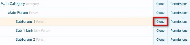

Hi..love the addon.
Just a note, there appears to be a conflict between Clone Node and Drag and Drop Nodes in the ACP addon. When Drag and Drop Nodes in the ACP is enabled, the Clone Node column does not appear. Not a big deal, but thought I would report it.
Thanks
Leslie
Hi..love the addon.
Thanks
Leslie
Hi, and thanks.
The Drag & Drop add-on uses it's own custom node-list template, and that is why the Clone Node column disappears (the admin template mod fails). I've made a change to the admin template mod that should fix this. I'll upload it shortly.

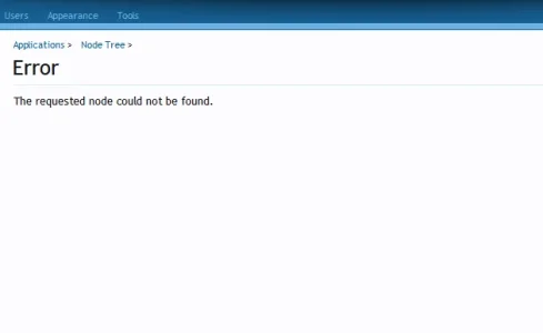

Hello,
here also - when i click to clone a element, it comes up a blank Template with:
and when i mouse over, over the link under every clone button i see by all elements the same link:
xenforo 1.4.4 and clone nodes 1.0.3 without drag and drop installed.
Regards
Sorry, I didn't receive any alerts that this thread was replied to. I just re-installed my Clone Node add-on and it works as intended. It would seem another add-on is interfering with the Admin Template Mod. The template mod used to insert the Clone link uses the $node already exposed to the template, so the link should be built corrrectly.

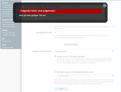

Hallo ich bekomme immer eine Fehlermeldung, wenn ich eine Kategorie oder Forum Clonen möchte
Bitte um Hilfe
