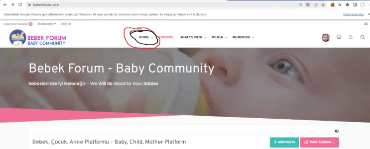

XF 2.3 I want to change the Home section that I showed in the picture from the general navigation area to the "baby portal".
Baby Community
I want to change the Home section that I showed in the picture from the general navigation area to the "baby portal". I couldn't change it. What should I do? Because when I click on the Home section, the xenporta add-on appears (There is a portal)

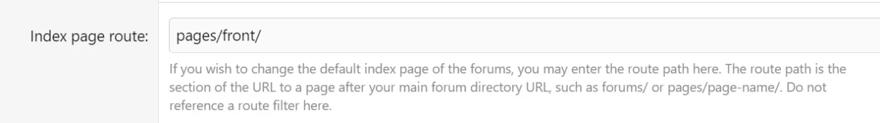

When you say the 'baby portal' do you mean the forums? It's difficult to discern which section you mean by using the word 'portal' seeing as there is already a portal in place. If you want the forums to be the main viewpoint when visitors enter your site, then you need to change the primary index page route filter in the basic options section:
If I'm reading you correctly, you would need to change this to forums/ with the trailing slash. You would then need to get rid of the home button and create a navigation entry for your xenporta page, unless you intend to drop it. You would do this in the options/public navigation section.

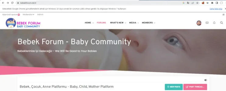

There is a Portal on the Home and forums in the Forums Section. I will change the Home section to Baby Portal.
I know how to change the route filters. I already changed the link.Portal Page is /baby-portal/
This is the part I want to change, I uploaded it as a file
Baby Portal
I understand that you want the Home button, but where do you want it to point to, as it's already pointing to baby-portal? If you want to point to forums and make forums your Home page, and NOT baby-portal, you are going to have to be creative with the public navigation section and create new entries with links to those points. It's easy enough to do, but not so easy to explain, at least not for me, lol.
The link you entered for baby-portal can only have one destination so you need to decide which it's to be.
