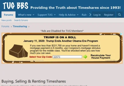

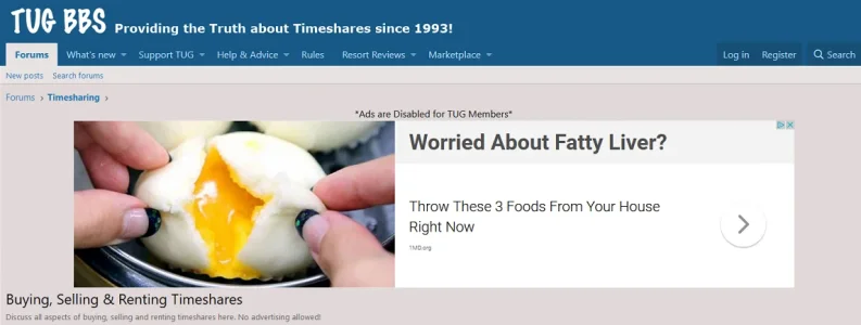

for example if my page is set to full screen, it displays this gigantic obnoxious banner graphic (that is again, totally unrelated to travel or similar)
the main "top" banner placement I am using is Container breadcrumb (top): Below ...which puts the ad roughly where we had it displayed within xen 1.5 (which just below the navigation boxes etc). perhaps it needs to be moved ABOVE the breadcrumb vs between it and the main forum headline etc...
I used this resource to choose where the ads would be displayed for reference:
I can confirm different ads display for different sizes in that location, even huge gigantic ads when I blow out the screen to full width, or shrink it down to 300pixels wide (or look at it on the phone).

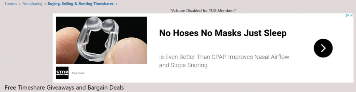

shrinking the very same page down and refreshing it shows another completely unrelated ad:
so clearly the responsive ads are working, they just are no longer even remotely related to the content of the site like they used to be. and that would certainly explain the staggering drop in clicks/rpm...despite traffic/impressions/etc all remaining identical.

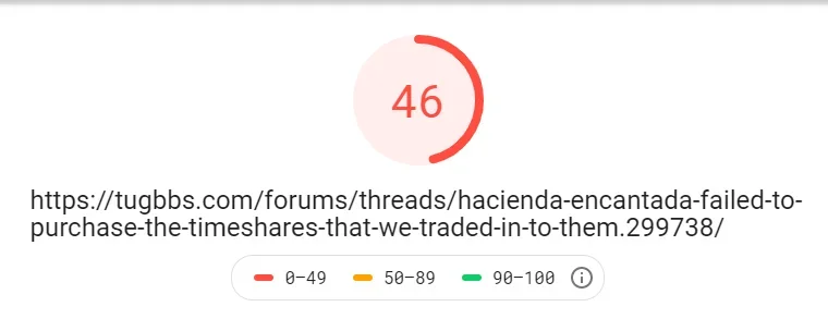

This is the score on mobile of a thread with 3 posts only, Google page speed:
I think you should focus on making the site faster

ironically the biggest impact to the speed score when I run the report is from the google ad script itself....
