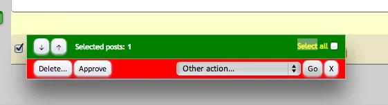

Thanks Tracy, I have tried your suggestions. But I still did not find the area that below color take effect, although I find them in the templates, but in front end I can not find the corresponding places.
@tooltipBackground /inline_mod.css
@inlineMod /inline_mod.css
@secondaryMedium /help_smilies.css

Are you familiar with using Chrome Developer or the FireFox equivalent. Normally you can find those by that.
There are several sections for the inline mod (if it's where I am thinking about)
#InlineModOverlay .selectionControl (believe this was the green)
#InlineModOverlay .actionControl (believe this was the red)
#InlineModOverlay .SelectionCount (white text)
#InlineModOverlay label (yellow text)
control the backgrounds and some of the text of the inline mod (in EXTRA.css).
Thanks Tracy, got it.
