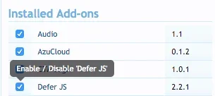

You do not need to have a plugin disable/enable checkbox as it already exists by default.

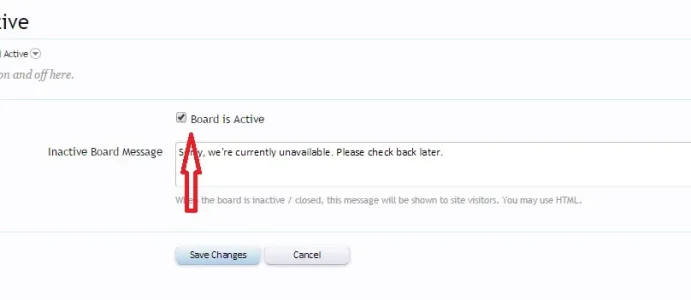

how to check to enable or disable the plugin?
Are you talking about adding it to your add on? If so, when you create your option in the admin panel, you must set Edit Format to On/Off Check Box and Data Type to Boolean. And for Default Value, enter 1 if you want your option to run when excecuted, otherwise 0 or leave it blank. You must also remember that to be able to add options, the developer mode must be enabled.
