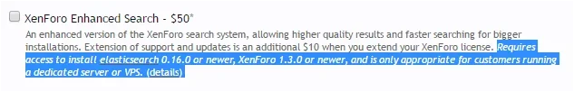

Are you referring to this?
"XenForo Enhanced Search requires XenForo 1.1.1 or newer and elasticsearch 0.16.0 or newer. The Enhanced Search add-on requires a separate purchase to become available to a XenForo license."
Three different people saw this and did not digest that in order for ElasticSearch to work in XenForo you have to not only buy XenForo Elastic Search 1.1.4 but .... I guess you also have to buy software directly from ElasticSearch?
Such fine print.
And nothing in the purchase, installation, or setup says "This will not work unless you also buy the server software from ElasticSearch directly"
Is that basically what we are missing?
The elasticsearch software is free - it just needs to be installed on the server and set up.
I'm surprised no-one recognised that it's a separate package - the word is linked to the site which distributes the software.
It was because of the phrasing I think. Here is how our strange brains interpreted what was written:
The first paragraph:
"XenForo Enhanced Search is an add-on that ... is built on top of elasticsearch"https://www.elastic.co/
We took this as just an FYI. You're buying an Add-On from us that is built on ElasticSearch. And here's a link to their home page if you're curious about it.
So we assumed whatever was needed was included with the Add-On.
The highlighted text below that says:
"The Enhanced Search add-on requires a separate purchase to become available to a XenForo license."
We assumed the separate purchase was the Add-On itself, which it is.
However there is this sentence: "requires XenForo 1.1.1 or newer and elasticsearch 0.16.0 or newer."
We assumed you were just letting us know that v16 of elasticsearch was part of the AddOn.
Why did we make that ridiculous assumption?
Because in context - there is no mention anywhere on this page, or the install text file that you must actually *go* to the ElasticSearch website, find their software, download it, set up repositories, and get their service running on your box before the AddOn will work. That entire process is not even mentioned, and is completely left out.
It does mention that the AddOn requires elasticsearch 0.16.0 to work, but it doesnt say its a separate "service" - just implies its their software, which could've easily been bundled with the AddOn. Ultimately we realized the AddOn was looking for a service on our box, so we realized a service was needed, but we sat there on the phone saying (out loud) "Why don't they actually say that anywhere in either of the installation instructions?"
Brain farts on our part. Maybe adding a couple sentences to the installation instructions will make it more clear for dummies like us. :)
Linking to the actual download page on ElasticSearch would've made it clearer too.
