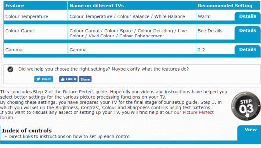

Hopefully some brilliant Xenforo guru will be able to help me.
What I want to do is replicate what I had working in a Xenforo 1 page.
Here is the code I had relating to the specific script used for the example below. (This code technique was replicated to create multiple expanding tabs):

and here is the effect in action:
Have already used some code to create expanding divs, but it doesn't work on the structure of the code needed to create tabs like this.
Can anyone help with code that works please?
Many thanks in advance.
