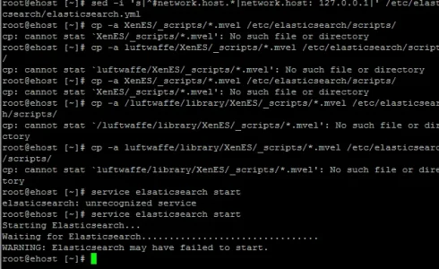

I've done this - but when I type "chkconfig elasticsearch on" Nothing happens, just goes to the next line ready for the next command
Then I get this error when trying to start elasticsearch:
Check the error logs to see why its failed to start.
/var/log/elasticsearch

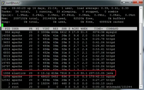

@Floren I installed ES using your repo. I'm using ES 1.3.2 and have set ES_HEAP_SIZE="512m" on etc/sysconfig/elasticsearch however the ES process is actually using 615m of RAM! It looks like ES is ignoring the config file... maybe you did something wrong when packing the files?
The heap size isn't the only thing involved in a Java wrapper. There are other things which consume memory also. The heap size is only the part which ES will use for loading the data.
root@ehost [~]# elasticsearch start
Failed to configure logging...
org.elasticsearch.ElasticsearchException: Failed to load logging configuration
at org.elasticsearch.common.logging.log4j.LogConfigurator.resolveConfig(LogConfigurator.java:117)
at org.elasticsearch.common.logging.log4j.LogConfigurator.configure(LogConfigurator.java:81)
at org.elasticsearch.bootstrap.Bootstrap.setupLogging(Bootstrap.java:94)
at org.elasticsearch.bootstrap.Bootstrap.main(Bootstrap.java:178)
at org.elasticsearch.bootstrap.Elasticsearch.main(Elasticsearch.java:32)
Caused by: java.nio.file.NoSuchFileException: /usr/share/elasticsearch/config
at sun.nio.fs.UnixException.translateToIOException(UnixException.java:86)
at sun.nio.fs.UnixException.rethrowAsIOException(UnixException.java:102)
at sun.nio.fs.UnixException.rethrowAsIOException(UnixException.java:107)
at sun.nio.fs.UnixFileAttributeViews$Basic.readAttributes(UnixFileAttributeViews.java:55)
at sun.nio.fs.UnixFileSystemProvider.readAttributes(UnixFileSystemProvider.java:144)
at sun.nio.fs.LinuxFileSystemProvider.readAttributes(LinuxFileSystemProvider.java:97)
at java.nio.file.Files.readAttributes(Files.java:1684)
at java.nio.file.FileTreeWalker.walk(FileTreeWalker.java:109)
at java.nio.file.FileTreeWalker.walk(FileTreeWalker.java:69)
at java.nio.file.Files.walkFileTree(Files.java:2600)
at org.elasticsearch.common.logging.log4j.LogConfigurator.resolveConfig(LogConfigurator.java:107)
... 4 more
log4j:WARN No appenders could be found for logger (node).
log4j:WARN Please initialize the log4j system properly.
log4j:WARN See http://logging.apache.org/log4j/1.2/faq.html#noconfig for more info.
No idea how to read the /var/log/elasticsearch directory
