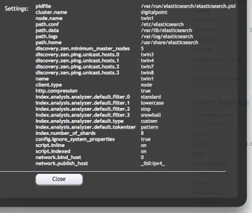

The main difference from older version to new version for us was that ElasticSearch no longer uses multicast to discover sibling nodes. It switched to unicast and you need to define host(s) that act as "gossip routers" for discovery. That really was the only thing I think. If it helps, this is our settings:
Since we are not using that feature, we should probably be OK then.
