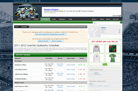

I added a screen shot of what my SCHEDULE page looks like. You can see that the custom NAVBAR option lights up. Each external pages uses the BASE Right Rail from the PAGE_CONTAINER template. You can add elements to each template between the <xen:sidebar></xen:sidebar> tags.
Holy crap that was a lot longer than I thought it was going to be. I will do my best to answer questions. :) The name of the game here is to just play. That is pretty much what I did and I came up with this. :) I will have my site launching in about 48 hours so you can see a live demo or get this going on your own. Good luck and I love this damn software!

whoa.
That page looks great !
So good, I'm giving it my Xenforo T-Shirt award ! :)
Addendum: I don't think the Seahawks are going to be effective at selling women's shampoo, but hey, I'm not in marketing !

haha... after I posted it I thought of refreshing the page and getting a new ad, but now I am just going to let it ride. :) (got to love Google)
