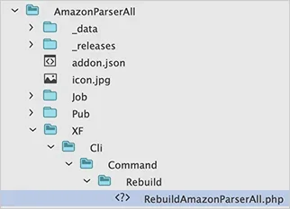

I created this file:
PHP:
<?php
namespace Andy\AmazonParserAll\XF\Cli\Command\Rebuild;
class RebuildAmazonParserAll extends AbstractRebuildCommand
    protected function getRebuildName()
        return 'amazonparserall';
    protected function getRebuildDescription()
        return 'Rebuilds amazon parser all.';
    protected function getRebuildClass()
        return 'Andy\AmazonParserAll';
I get the following error:

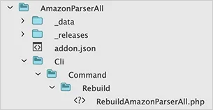

It's not extending a core class, so it shouldn't be namespaced under an XF directory. And you'll need to import the abstract class.
Thank you, Jeremy. I really appreciate your help.
Here's the correct code:
RebuildAmazonParserAll.php
PHP:
<?php
namespace Andy\AmazonParserAll\Cli\Command\Rebuild;
use XF\Cli\Command\Rebuild\AbstractRebuildCommand;
		return 'Andy\AmazonParserAll\Job\AmazonParserAll';

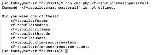

To run from CLI:
php cmd.php xf-rebuild:amazonparserall
