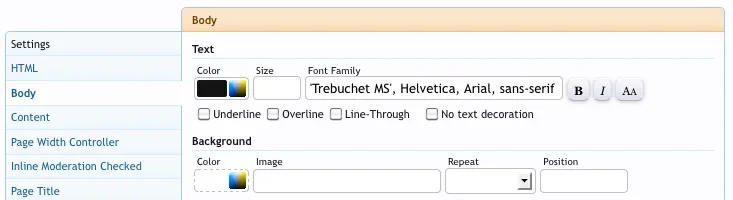

Quick question: How do I change text color on the overlay / member card? WITHOUT changing colors in the color palette. I have the colors as I like them now, but the only problem is that in the overlay the text is just a bit too dark.
Can it be done in the style properties?

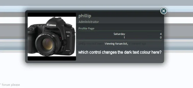

It worked partly, there is still the old color on for example "from", "member since", "post count", "X was last seen" etc. What did I miss out? :)

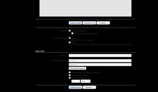

Another problem is the text at the bottom of the New Post screen is dark on a dark background. where do i go to fix that?
Found another problem. When i pin a thread it turns purple and i haven't set anything to purple
Can you post screenshots or URLs showing those problems?

The problem i have with the default skin now is in the attached pic.dark text.jpg
Russ
Hi Jake. I uploaded another skin last night and that seems to have fixed the problems on the default skin, no idea why.
The problem i have with the default skin now is in the attached pic.View attachment 11042
Not sure about style properties for that one but in extra.css you could add:
        .xenOverlay.memberCard .userInfo .userStats th
            color: #FFFFFF !important;
Also wi11ie if you have FireFox, check out: http://getfirebug.com/ it can help you speed through the skinning process like no other.
#FFFFFF being whichever color or @primaryLight
Jake Bunce
XenForo moderator
Staff member
See my previous two posts. Use that code in the EXTRA.css template to change that dark text color from your picture:
Try this:
.xenOverlay.memberCard .lastActivity dt
	color: @primaryLight !important;
.xenOverlay.memberCard .userStats th
.xenOverlay.memberCard .muted

Thanks Jake and Russ that worked a treat :):)
Which controller is used for the lower text in this pic to brighten it please and its the same on the login page

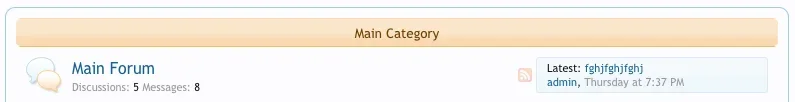

Now having done all that :):) How do i center the Titles of the forums, categories and board title in the bars? I remember doing it in VB but it was so long ago that i cant remember how i did it and where i did it.
Anyone :)
Admin CP -> Appearance -> Style Properties -> Forum List -> Category Strip Title
Add this to the Miscellaneous box:
text-align: center;
That will center the category titles:
