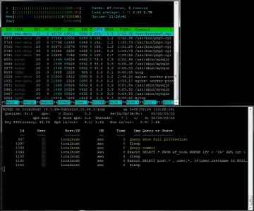

Using the top command, it's php5-cgi that's using all the CPU. Which logs would you recommend looking through?
Thanks
Well it was back to normal for 30 minutes. Now mysqld is choking the cpu.
Edit: I restarted mysql and now it's php going nuts again. Does anyone see anything terribly wrong here? I just turned on the slow query log and it's empty so far. Again, if I close the board the problem goes away.
