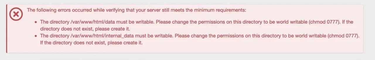

Ok, so I forgot how to fix the following two things since the last time that I installed XenForo-
The following errors occurred while verifying that your server can run XenForo:
The directory /var/www/html/data must be writable. Please change the permissions on this directory to be world writable (chmod 0777). If the directory does not exist, please create it.
The directory /var/www/html/internal_data must be writable. Please change the permissions on this directory to be world writable (chmod 0777). If the directory does not exist, please create it.
Please correct these errors and try again.
The sooner the help, the better :D
Thanks in advance

use commands:
chmod 777 /var/www/html/internal_data;
chmod 777 /var/www/html/data
