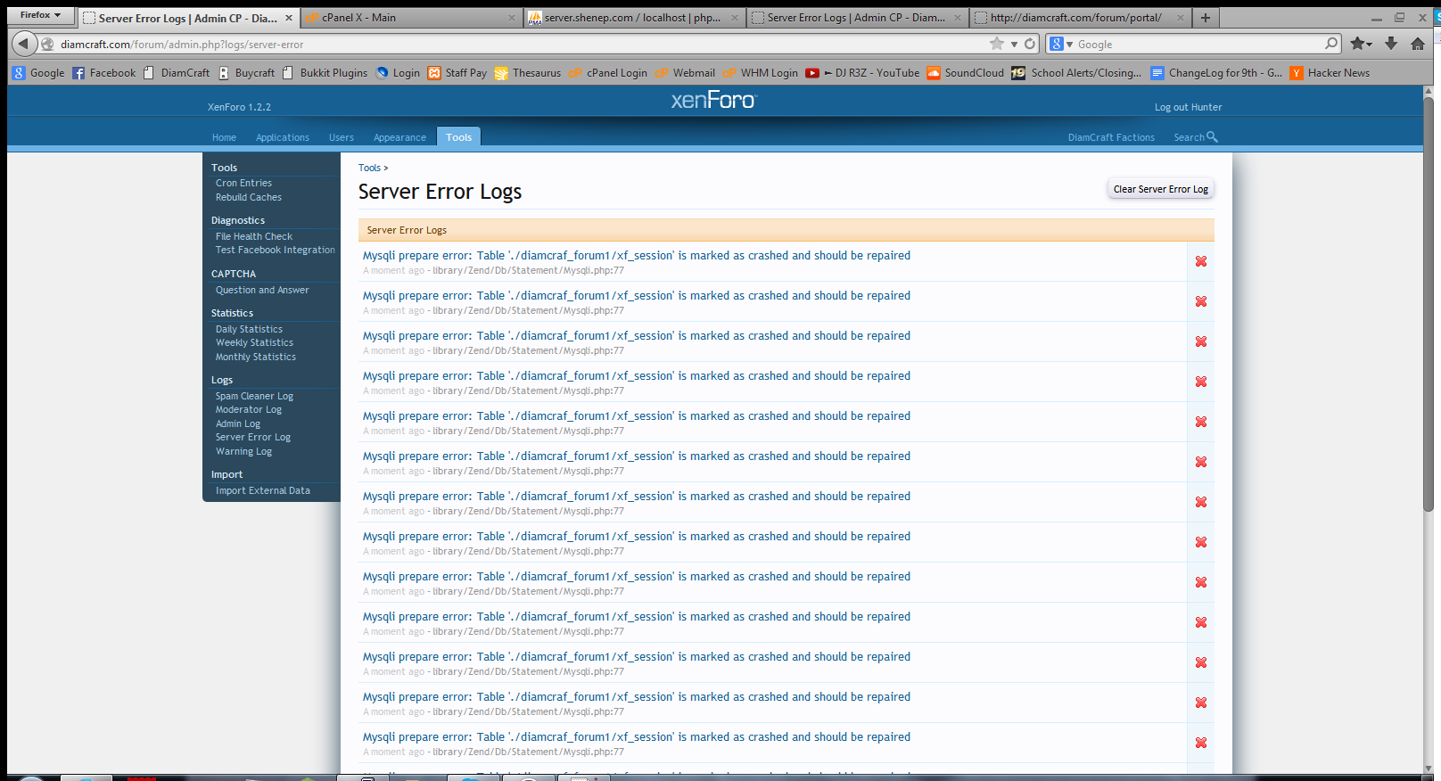

I don't have a backup of when the forum last worked correctly. If I move to a new host with my corrupted database is it repairable by following the steps in this thread or do they have to fix it? How would they do that?
Jake B.
From what it looks like it's only the xf_session, so even if it isn't able to be repaired it shouldn't be a huge deal to just recreate the table. Users will be logged out, but no posts/threads/users will be lost
