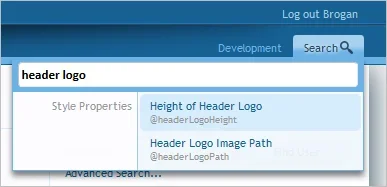

Thank you, I could not find this setting in the admin panel? The only settings I could find where for all the other elements such as menu bars, logo etc.
upload_2015-6-16_19-36-38-png.108686

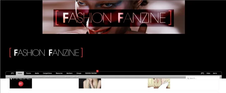

Sorry to say nothing changes was incorrect, the space above logo is larger if I change the values. However the issue with logo and menu pushing over the content remains the same:
If you're putting something with variable or dynamic height in the header, you'll likely need to change the structure of the page. The default system uses an approach that requires the header to have a known height (though it speeds up content loading).
