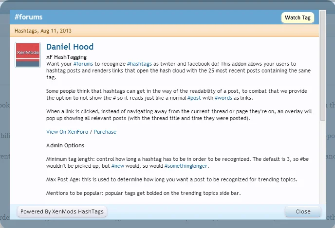

I dont like the fact that it only shows most recent Hashtags in the page, instead of most popular one before X date.
Well the main page shows the most recent. I'm not opposed to changing it to the most commonly used ones, I just don't know in general if that would be well received. The concept I had was to show the trending topics. I'm very open to changing the index though.

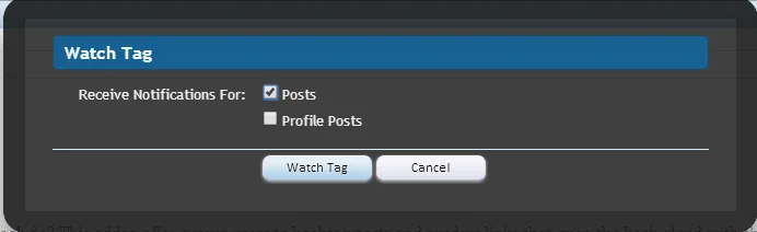

This is fixed in Beta 3 which I will be posting later this evening. I'm working on implementing the ability to watch hashtags (to receive alerts when new content has been posted with that tag).
