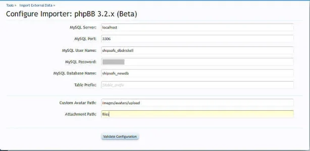

As a side note, I have already tried this and entered the database credentials that the data is "coming from" and thought I had all the correct info. The XF page returned that it did not recognize any of the info I plugged in. Now that I remember, I forgot to put in the file path info.
I am willing to provide any extra info requested.
Ok, for the first real time - - - back to the drawing board. This is the response I got:
  • The table prefix or database name is not correct.
  • The attachments directory could not be found.
  • The avatars directory could not be found.
Yes, I have read the guidelines and will continue to read. I am wondering about the table prefix. I don't think I have a table prefix.
The only database names I have is shipsofs_newdb (db for PHPBB) and shipsofs_xenforo (db for XF)
I checked the avatar and file path and both are ok.
Since I did not know the Table Prefix, I just used the same shipsofs_newdb (db for PHPBB)
I might go back again and leave the Table Prefix blank.
The image paths are relative to the XF installation directory so unlikley to be what you have entered.
If you can't work out what the relative path is, use the absolute path.
Well, all the imports passed ! Wow. Now to rebuild the search index.
Yes, the absolute path had to be done for both. Also figured out the table prefix for PHPBB forum: it was phpbb_ is the way I entered it.
