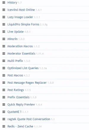

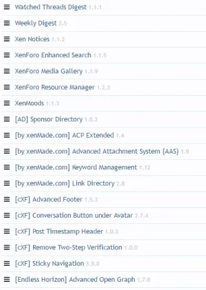

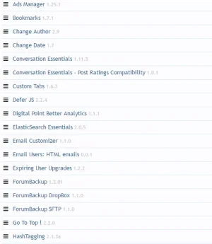

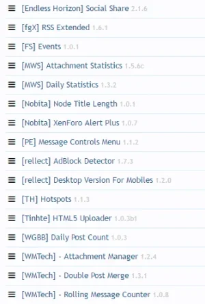

Still have access to ACP. I disabled all addons.
